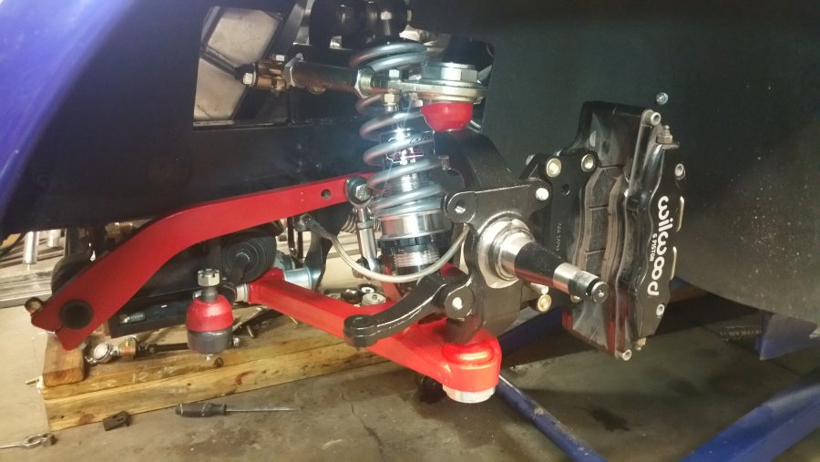

Front Suspension
Custom built lower control arms and bushings. Upgraded lower control arm mounts on frame. SPC upper control arms. QA1 ball joints and coilovers. Speedway engineering sway bars with Heim joint links.

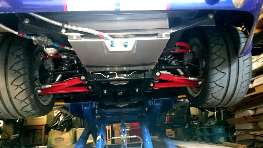

Rear Suspension
Scratch fabricated independent rear suspension. Upper and lower control arms and uprights. Using Ford 8.8 aluminum differential from Explorer, as well as the wheel bearings and modified half shafts. Diif contains Eaton True Track module.
Brakes
Wilwood 12.2" rotors with 6 piston calipers front and 4 piston rear. Wilwood tandem master cylinder mounted to a custom mechanism that rotates master cylinder position 90 degrees. C4 corvette single stage vacuum brake booster with electric vacuum pump and vacuum reservoir. Proportioning valve mounted in cockpit for on the fly adjustment.

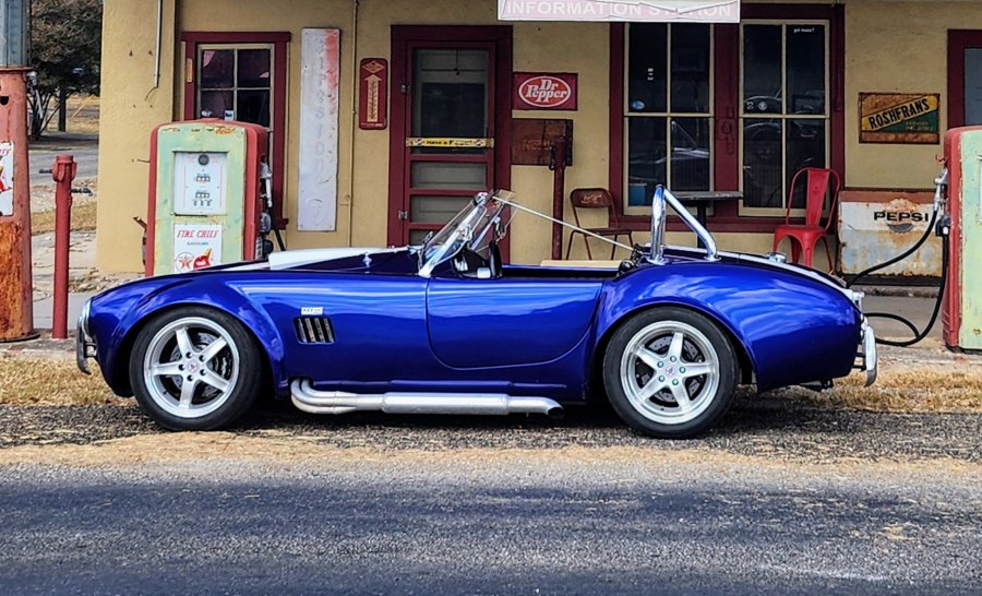

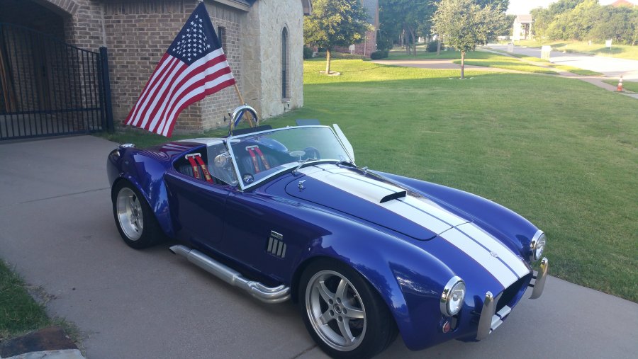

Color Details
Metallic blue with white stripes and red pinstripe

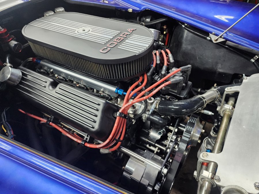

347 Stroker
Ford Windsor
Custom built fuel injection system based on Megasquirt 3 control system. Edelbrock 1000CFM throttle body. Edelbrock injectors and fuel rails. Aeromotive pressure regulator. Holley lift pump feeding 1/2 gallon surge tank with Walbro injection pump. Stainless steel rigid fuel lines.
Valve Train Details
Standard pushrods with 1:6 ratio stainless steel rocker arms.
Ignition
Custom ignition system controlled by Megasquirt 3. Added Bosch coil drivers to circuit and connected 2 - 4 way coil packs in place of the distributor. System operates in wasted spark configuration. Windsor cam sensor module installed in place of distributor to operate oil pump. Custom made 36-1 trigger wheel on crankshaft with DIY Auto Tune Hall effect sensor.
Exhaust
1-3/4" stainless exhaust header feeding into 3" collector. Glass packs fully welded on side pipes to prevent rattles.
